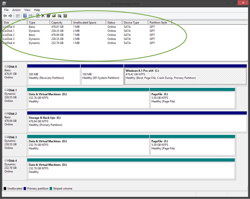

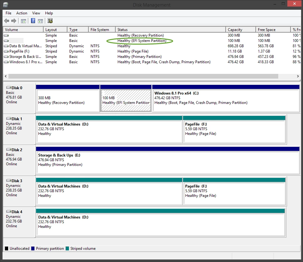

Here is a snapshot of my UEFI, GTP system! Maybe you can see what I'm talking about?
Daniel ;)

"Here is a snapshot of my UEFI, GTP system! Maybe you can see what I'm talking about?
Daniel
i know what your talking about i just wanted to clarify that uefi can have either GPT or MBR partition style and that GPT has an MBR fake in a normal GPT not so in a hybrid GPT (used primarily in macs for compatibility)
in theory if the MBR is a fake decoy then itll do nothing to GPT thinking it fouled the pc but if the MBR is a compatibility layer it might foul the GPT too(im not real sure of the particulars of the implementation of the fake mbr in a normal GPT let alone a hybrid one)
EDIT: after a little research 0xee, the sole entry in the fake mbr, is the hex for an efi boot partition now the question becomes is the entry integral or seperate as in does the gpt refer to the fake mbr for the location(integral)  of the efi partition or does it maintain its own(seperate).
i wonder if thats the difference between hybrid (integral?) and normal (seperate?)
